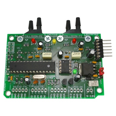

Ardumower's bumper sensor (called 'BumperDuino') is based on a pressure sensor and helps us to detect obstacles.
The PCB module and sensor can be purchased as complete kit via the shop Shopping.png .
Building instructions
Building instructions as well as instructions for programming the Arduino can be found in the BumperDuino manual.

You can download the Arduino Code here. Important: Choose 'Arduino Uno' as bootloader.
To upload the code, set jumper to 'VUSB' and connect an USB-TTL adapter to J4 (USB-LIGHT) as follows:
J4 (USB-LIGHT)
1 -- USB-TTL GND
2 -- not used
3 -- USB-TTL +5V
4 -- USB-TTL TX
5 -- USB-TTL RX
6 -- USB-TTL DTR (reset)
All steps are described in more detail here: FT232RL USB-adapter manual.
Connecting to Ardumower
Set jumper to 'VIN', and connect VIN and BUMPER-OC to Ardumower as follows:
BumperDuino VIN +    -- PCB1.3 +9V
BumperDuino VIN -    -- PCB1.3 P11 GND            (2)
BumperDuino OC DC1   -- PCB1.3 P11 pinBumperRight (3)
BumperDuino OC DC2   -- PCB1.3 P11 pinBumperLeft  (4)

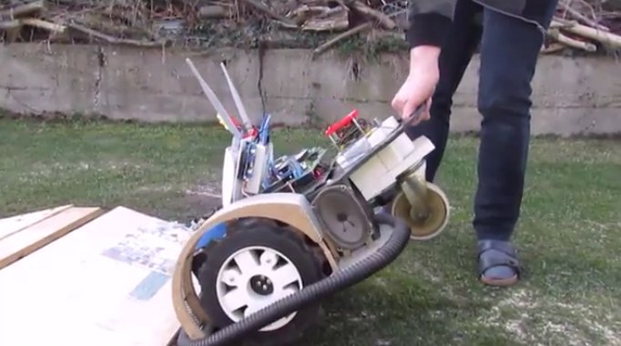

  3. Neue BumperDuino Version mit Unterfahrschutz
BumperDuino and tilt protection
The BumperDuino is permanently improved. Here you can find a version including tilt protection:
BumperDuino using tilt protection
