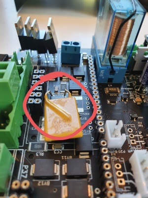

'''Yellow Fuses on the PCB1.4:'''
Take care that the yellow fuses on the PCB1.4 do not get in contact with the BL adaperter board. This can blow up the motor driver board!
[[Datei:20210528 115240.jpg|300px|Fuse on PCB1.4, wire going up, over the fuse before they turn down]]

Yellow Fuses on the PCB1.4: Take care that the yellow fuses on the PCB1.4 do not get in contact with the BL adaperter board. This can blow up the motor driver board!
