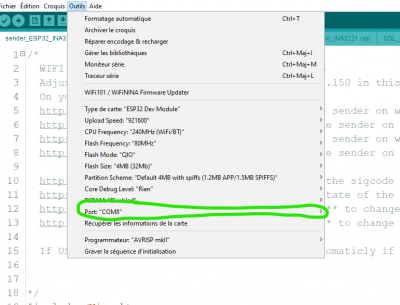

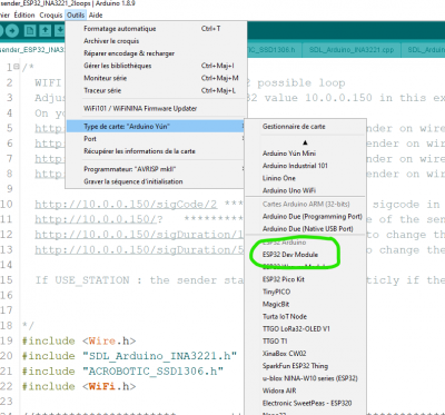

Open your Arduino Ide 1.8 or later
Select ESP32 DEV Module and correct COM port, do not forget to change the partition scheme (See Image 3 , app is too big for standard ide setting.

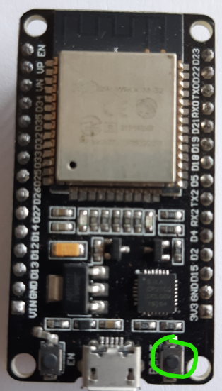

When you upload code : At the end of compilation when you see "connecting ....." --> push the BOOT button locate on ESP32 DEV KIT for 5 sec until uploading begin.

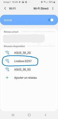

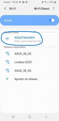

First you need to connect your Phone or tablet to correct WIFI point.If mower can't find your home wifi on startup it change to AP mode , so you can see in your WIFI list a new apparel named ROBOMOWER ,Try to connect to it without password, else if you use the station mode ,simply connect your phone to your router .
Mower is the ACCES POINT ,No connection with your home network. Mower IP address is 192.168.4.1
Mower is connected to your home network. Mower IP address is the one you set in config.h

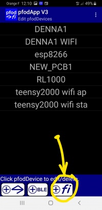

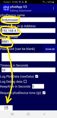

In Pfod app you need to set the correct IP and Port according the value you have in ESP32 firmware config.h.

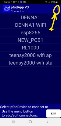

Start Pfod and simply follow these picture:
Pfod App name is what you want.In this picture IP adress: 192.168.4.1 is the mower ACCES POINT one.
After saving and go back ,Simply select the Pfod App name in Pfodapp connect menu.
