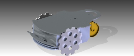

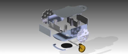

Ardumower 1.0 Chassis specifications
- Dimension (L/B/H): 60x36x25cm
- Total weight: approx 9 kg (including all components - motors, battery, PCB etc.)
- Adjustable mower motor height
- Mowing motor: 24V DC, 3150 rpm
- Mowing disc: 190mm diameter, 3 blades
- Wheels: 250mm diameter
- Gear motors: 2 x DC 24V planetary drive, 33 rpm, with integrated encoders
- Battery: Lithium-Ion 29.4V
