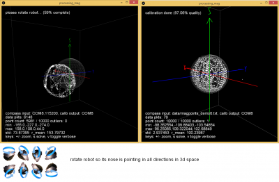

# Move IMU out of robot and power-on robot. | # Move IMU out of robot and power-on robot. | ||
# Start 'processing_mag'. | # Start 'processing_mag'. | ||
| − | [[File:Compass_calibration.png | + | [[File:Compass_calibration.png|400px]] |
# Ensure there is at least >1m to all metal parts in the surrouding. | # Ensure there is at least >1m to all metal parts in the surrouding. | ||
# Rotate IMU module slowly into all directions and collect > 20,000 measurements. | # Rotate IMU module slowly into all directions and collect > 20,000 measurements. | ||

- Install IMU module 35cm away from metal parts. Use 1m cable so you can move the module out of robot for calibration.
. Do no use metal parts (screws etc.) within 5cm of the module, use plastic screws. Fixate everything within 5cm of the module. A small movement of a cable etc. will make the calibration useless.
- Move IMU out of robot and power-on robot.
- Start 'processing_mag'.
- Ensure there is at least >1m to all metal parts in the surrouding.
- Rotate IMU module slowly into all directions and collect > 20,000 measurements.
- Install IMU module in robot at least 35cm away from metal parts.
