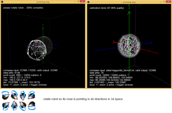

  4. Ensure there is at least >1m to all metal parts in the surrouding.
  5. Rotate IMU module slowly into all directions and collect > 20,000 measurements. Calibration ist performed transmitted continously to robot (robot confirms with a tone).
  6. Install IMU module in the robot at least 35cm away from metal parts.
