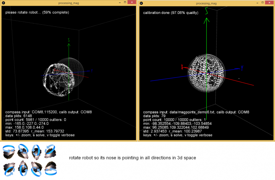

# On the PC, start 'processing_mag'. [[File:Compass_calibration.png|800px]]
# On the PC, start 'processing_mag'. [[File:Compass_calibration.png|900px]]

# Rotate IMU module slowly into all directions and collect > 20,000 measurements. Calibration ist performed transmitted continously to robot (robot confirms with a tone).

  1. Install IMU module 35cm away from metal parts. Use 1m cable so you can move the module out of robot for calibration. Do no use metal parts (screws etc.) within 5cm of the module - use plastic screws. Fixate everything within 5cm of the module. A small movement of a cable etc. will make the calibration useless. Verteileraufputzdose 2017-01-22.jpg
  2. Move IMU out of robot and power-on robot.
  4. Ensure there is at least >1m to all metal parts in the surrouding.
  5. Rotate IMU module slowly into all directions and collect > 20,000 measurements. Calibration ist performed transmitted continously to robot (robot confirms with a tone).
