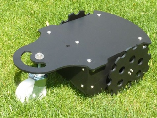

This page describes the assembly of the Ardumower chassis that you can purchase via the [https://www.marotronics.de/index.php?k=32 shop] [[File: shopping.png|link=https://www.marotronics.de/index.php?k=32]].
[[File: Ardumower-chassis.jpg | 500px]]

This page describes the assembly of the Ardumower chassis that you can purchase via the shop Shopping.png.
Ardumower 1.0 Chassis specifications
  • Dimension (L/B/H): 60x36x25cm
  • Total weight: approx 9 kg (including all components - motors, battery, PCB etc.)
  • Adjustable mower motor height
  • Mowing motor: 24V DC, 3150 rpm
  • Mowing disc: 190mm diameter, 3 blades
  • Wheels: 250mm diameter
  • Gear motors: 2 x DC 24V planetary drive, 33 rpm, with integrated encoders
  • Battery: Lithium-Ion 29.4V
  • Max. incline: approx. 30%
