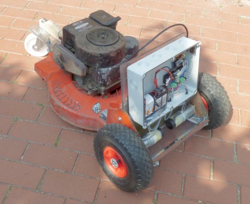

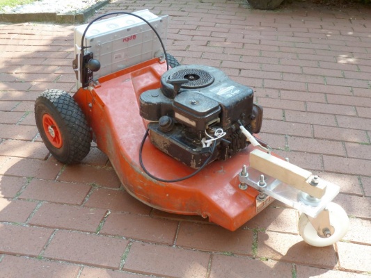

Ardumower Gasoline R/C is an ordinary gasoline powered mower converted to remote control (R/C) using Ardumower parts.

Motors
Find a place on your mower for the gear motors. Use the clamping elements and the tire adapter to attach the tires to the motors.
Free wheel
