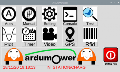

Piardu Help
Main Menu
If you click on the ardumower logo you can see the info page.
Click on Power Off is the normal shutdown of the mower: Console is saved, Raspberry PI start to shutdown and after 1 minute all the PCB is power OFF.
All other icons are explicit.

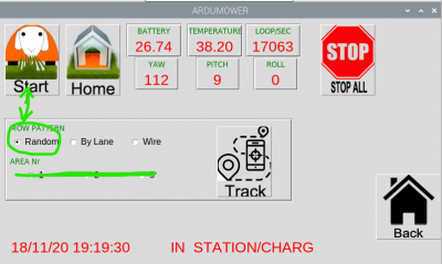

It's the initial start menu.
You can check here in the status bar the exact mode of mower
Date and time need to change each 1 seconde and loop/sec each 500 ms if everything is OK.
Start icon start mower in automatic mode with the MOW PATTERN selected (AREA NR option are ignored)
Stop All icon immediatly stop mower.
Home icon send mower to station
Track icon send mower to an other mowing area (work only with wifi sender and RFID option), Mower reach the perimeter wire and track until find RFID tag for new area and use MOW PATTERN selected

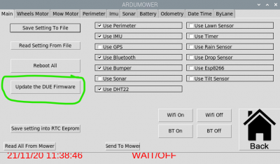

Main setting

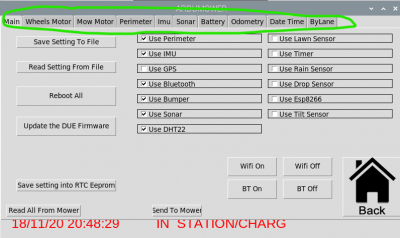

All page are store on tab item :

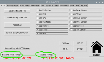

The Main Tab is the most important, You can here change main option of mower like Use Timer for example
Change are only validate if you click on send to mower, Be careful, all Setting change including other tab (perimeter,imu etc..), are send to mower
If you want that your change are here on the next mower restart, you need to click on Save setting into RTC eeprom.
It's also possible to save all setting on the raspberry file and restore it later using Save setting To File and Read setting from File.

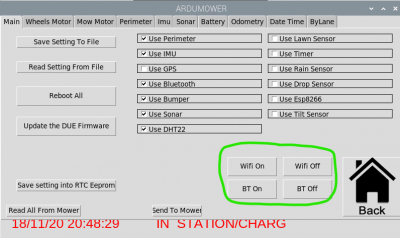

You can control the WIFI and RFID here ,so it's possible,(For example if use a screen and NO WIFI) to deactivate WIFI or Bluetooth.

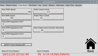

Simple Setting
Here some example of the other setting TAB, nothing particular except in the Perimeter and ByLane page.
DUE Firmware Update
You can upload a new version of AZURITBER inside DUE over WIFI.
JP8 need to be in always ON mode during the Flash process, When DUE flash it can power OFF PCB1.3 and flash fail.
If you do that by error flash again firmware normally with USB cable and programming port.

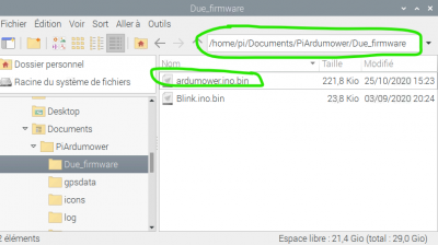

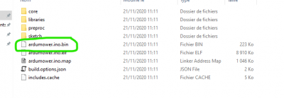

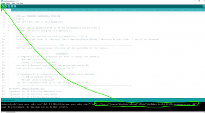

On your PC load source code into arduino IDE an simply compile it, at the end of compilation look at the penultimate line, you can find the directory where IDE compiler store the bin file named.
Locate this directory and check that ardumower.ino.bin is present with correct date time
Now use VNC to transfert file ardumower.ino.bin from your PC to Raspberry PI ,Under folder Piardumower/

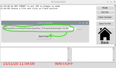

If the file is present you can now click on UpDate the DUE Firmware button
Before click on Start Flash : check that JP8 is in always ON mode
Click on Start Flash and wait less than 2 minutes : process if faster than with PC and programming port. After a while Due Flasher page disappear and check in console than restart is OK with new firmware.
File ardumower.ino.bin is automatically delete from folder to avoid error on next flash : File can't contain "(" or special char
Do not forget to set JP8 in Autom Mode to protect battery

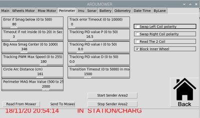

Perimeter Setting
Here you can find new button use to start and stop other area sender
IP adress of area 2 and area 3 sender need to be set into config.py file.
