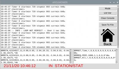

Console Page
Console is used to understand all what's append when mower is running
Contain can change according your setting in arduremote (Developer YES or NO) or into config.py (UseDebug
