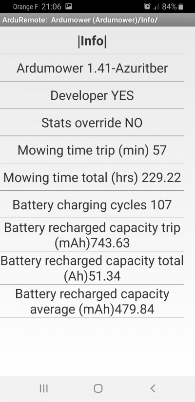

Contain can change according your setting in arduremote (Developer YES or NO) [[Datei:Arduremote info 1.png|400px]]  or into config.py (UseDebug
Contain can change according your setting in arduremote (Developer YES or NO) or into config.py (UseDebug
[[Datei:ArduRemote Info.jpg|400px]]
[[Datei:Piardu console 1.png|400px]]

Console is used to understand all what's append when mower is running
