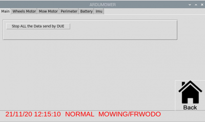

Setting Page
It's better to use ARDUREMOTE for general setting but you can find here an other access to simple setting.
Main setting

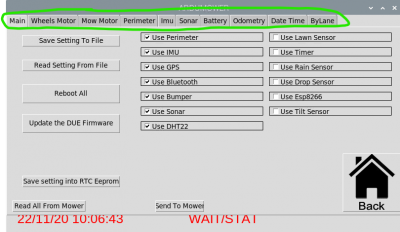

All page are store on tab item :

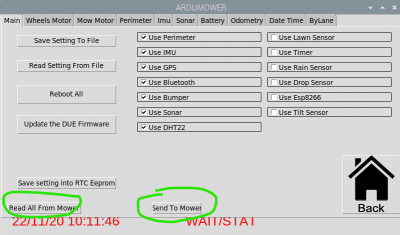

The Main Tab is the most important, You can here change main option of mower like Use Timer for example
Change are only validate if you click on send to mower, Be careful, all Setting change including other tab (perimeter,imu etc..), are send to mower
If you want that your change are here on the next mower restart, you need to click on Save setting into RTC eeprom.
It's also possible to save all setting on the raspberry file and restore it later using Save setting To File and Read setting from File.
Simple Setting
Here some example of the other setting TAB, nothing particular except in ByLane page.

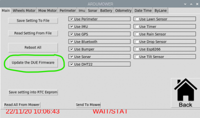

DUE Firmware Update
You can upload a new version of AZURITBER inside DUE over WIFI.
Warning.png JP8 need to be in always ON mode during the Flash process, When DUE flash it can power OFF PCB1.3 and flash fail.
If you do that by error flash again firmware normally with USB cable and programming port.

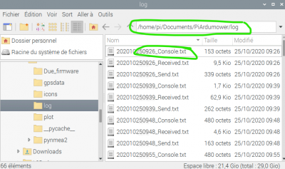

Console Page
Console is used to understand all what's append when mower is running,Bottom left list is NMEA coming from DUE,Bottom Right list is NMEA send to DUE
The Console Data are automatically saved on SD card when mower power OFF or when error occur.
Contain can change according your setting into arduremote (Developer YES or NO) or into config.py (UseDebugConsole)
Mode show Azurit message and change each time you click on it
List Var list all your setting
Save To File save all console data on Raspberry PI SD card in log folder

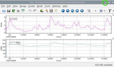

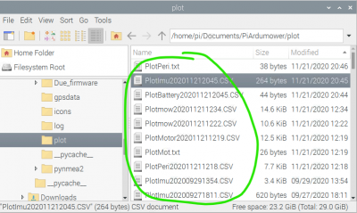

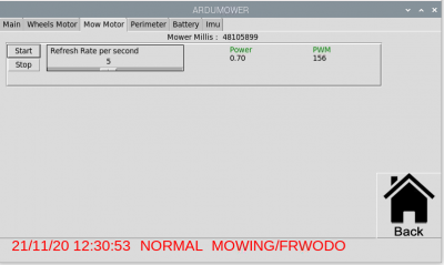

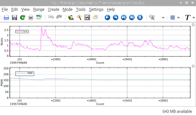

Plot Page

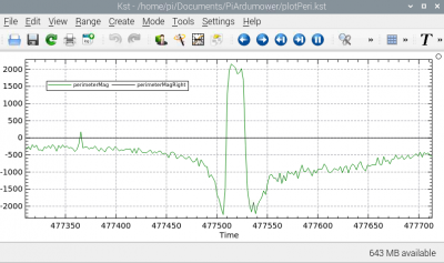

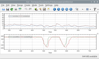

Piardu save data coming from due on SDcard and KST read the file in real time to show the data .
For more info see KST internet page : https://kst-plot.kde.org/
On each page you can select data frequency and click on Start :A refresh rate of 5 indicate that DUE send data each 200ms.
KST is automatically open and show the graph. Actually the last 200 value slide on the graph but it's easy to change directly into KST setting.

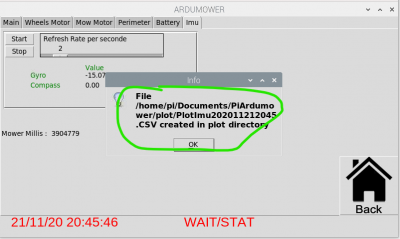

It's better to reduce KST windows and stop the plot on plot page (Avoid to close KST before stopping data)
When click on stop, a message show the name of the .CSV file generate by Piardu , so you can later copy it on your PC and read it using Excel for example.

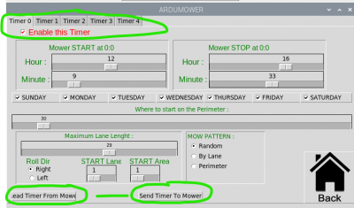

Timer Page
It's easier to use timer on Piardu because you can see all data in one page
It's possible to adjust 5 timers using the tab item (Never cross the timer start and stop hour for the same day)
Nothing particular except you need to click on Send Timer to Mower on each change and if you want that your change are here on next reboot
: save into RTC using setting menu
