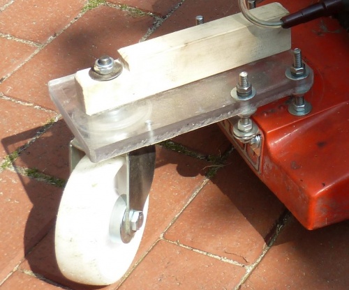

Free wheel
Use 4 screws and a plate to support the free wheel.
