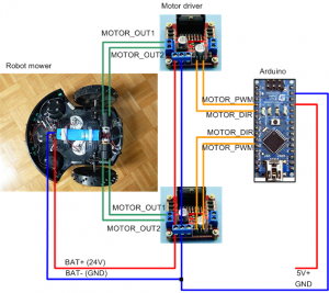

The motor driver is connected through control signals to the Arduino. Example:
Arduino Digital Pin —> MOTOR-DIR Pin Arduino PWM Pin —> MOTOR-PWM Pin Arduino Analog Pin <— MOTOR-Current Sensor Pin
One pin controls the direction (forward/backward), the other pin controls the speed One analog input pin is connected to the current sensor The current sensor module (ACS712-05A) is connected in series with the motor.

Features: up to 4A (for Tianchen TC-G158, Ambrogio L50, etc.) Notice: When using a L298N-motor driver, both H-bridges (2A) should be connected in parallel, so that both bridges drive a single motor (max. 4A):
Connect in parallel:
IN1 with IN4 IN2 with IN3 OUT1 with OUT4 OUT2 with OUT3
(Do NOT disconnect the SENSE-lines, except when you want to measure current by a 'shunt' resistor).
Make sure there is a jumper on both ENA and ENB. Also, make sure there is a jumper on S1.
