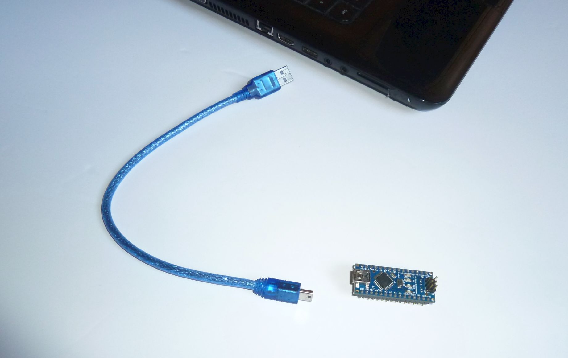

1. Attach the Arduino to your computer
Using an USB cable, attach the Arduino (Arduino Nano or Arduino Mega) to your computer as shown below.

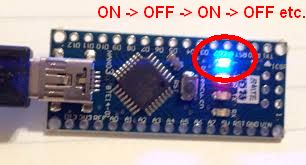

Click on the 'Upload' symbol to upload the blink example to your Arduino. After the upload completed, your Arduino will start to blink!
After the code is uploaded, your Arduino will start to blink:
Congratulations!
You have just programmed your first Arduino!
