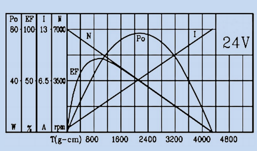

For the technical users, here are the motor specifications:
