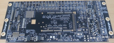

PCB size: 272mm x 115mm

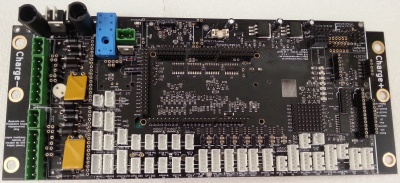

Soldering the mainboard components

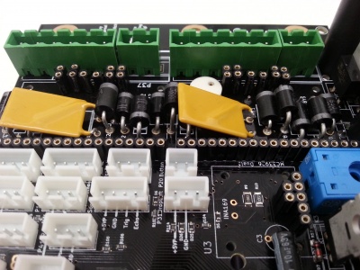

The assembly of the board is tricky as some components have been packed tightly - especially those below the motor drivers.
The following table lists each component to be placed by hand along with other components that might collide. Collisions marked with a '?' are hard (but still possible) to solder if the components are not placed in the right order. Those without a '?' are impossible. The table has been sorted to provide a practical order for soldering: low components come first and components blocking each other are in the right order. Similar components and spatiality has been used to form groups.

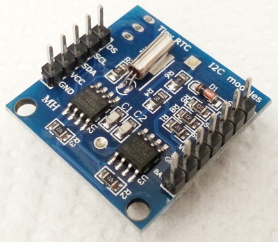

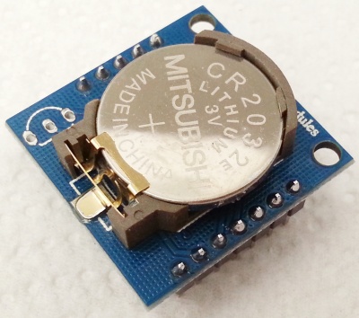

Soldering the RTC
Just insert a 5- and a 7-pin-row into the module. It's pretty easy if you insert the module into the main board while soldering.

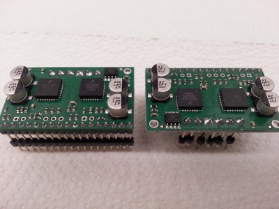

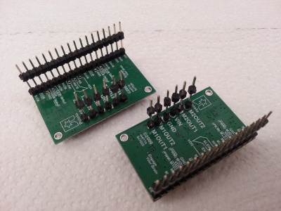

Soldering the motor drivers
For each of the both drivers: Insert a row of 18 stacking pins (the longer ones) row into the mainboard. Insert 6 separated stacking pins into the mainboard. Try to put the module onto those pins and solder them.

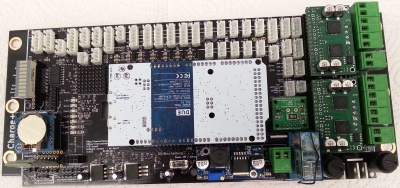

If you stick everything together, you have something that should look roughly like this:
