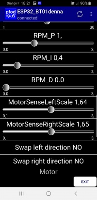

Motor Setting
3 Values are require and need to be set in this order:
Value 1
Go To : Main Menu / Setting / Motor
Here you can adjust the RPM max speed and PWM max speed
RPM is use into manual mode, so to check a new value simply go to Main Menu / Manual and drive forward.
PWM is use into automatic mode and need to be enought for the mower to reach the RPM max value.
If the wheel don't roll smoothly in manual forward ,you need to adjust the RPM PID
