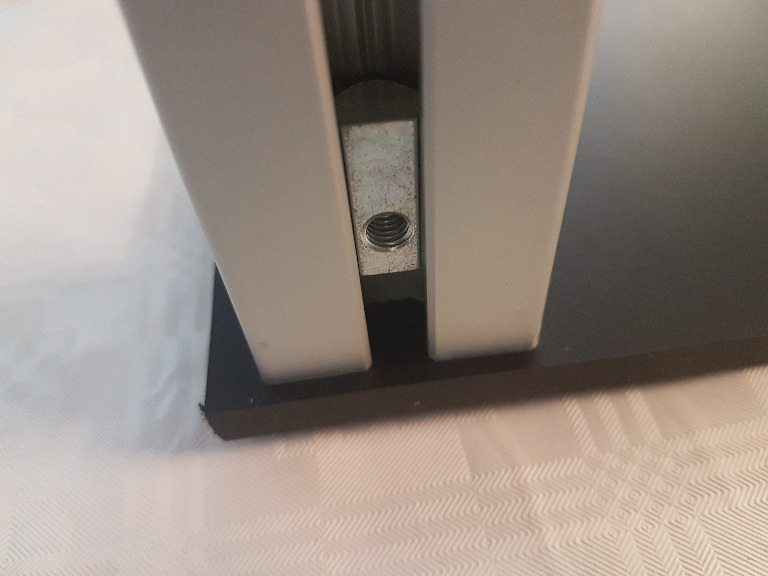

Case assembly
This assembly instruction is work in progress!

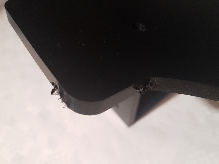

We recommend to smooth all parts and remove all edges with a file and/or sand paper.

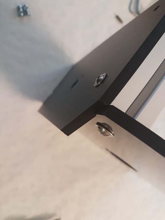

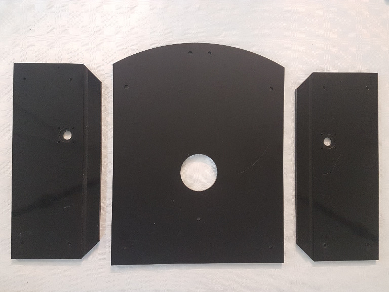

We start with the bottom, right and left board. You have to see you remove all the remaining plastic from the notch in the bottom board. Otherwise the side boards will not fit into it.

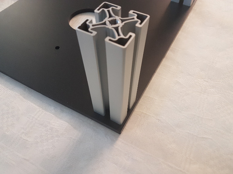

Then we take the bottom board and attach the first aluminium corner. It has the advantage to use the polished polished side of the bottom board downside that the grass sticks to it less well as to the matte side.
Then we put two M6 nut bolts into the corners.
In the next step, we attach the left and right side to the bottom board and fix them with the four M6 screws

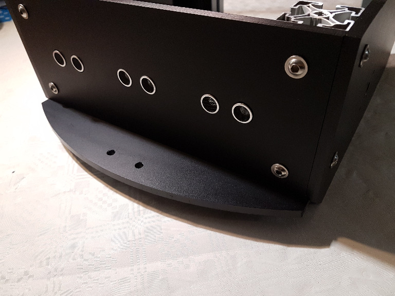

Then we take the front board. If you already know that you want to use the use ultrasonic collision detection, then remove the remaining plastic from the prepared six holes. Use again four M6 screws and the corresponding nuts and attach them between the right and left side of the chassis.

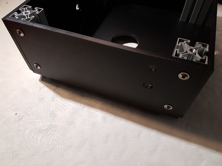

In the next step we prepare the holes for the rear side. It is recommended to prepare the holes for the charging connector and the start switch.
