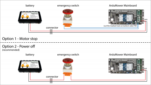

Wiring
There are two options to wire the emergency switch. Option 2 is the recommended version. If you realize version 1, don´t forget an external accessible power-Switch (close to "connector") .
