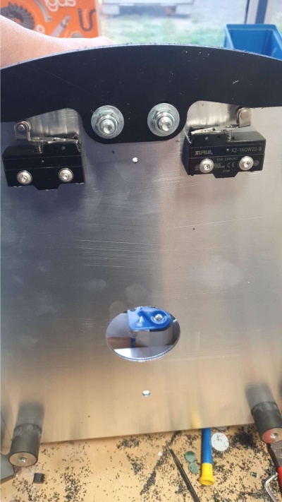

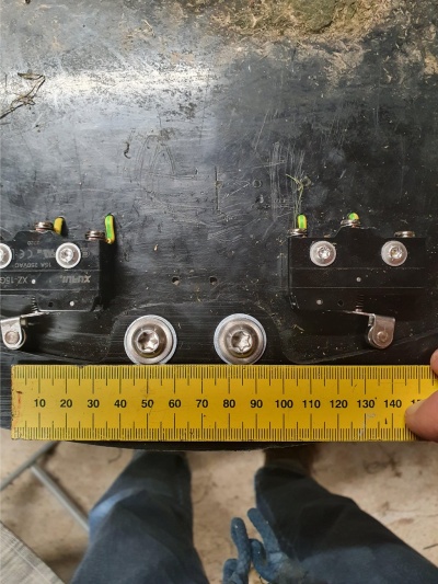

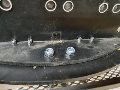

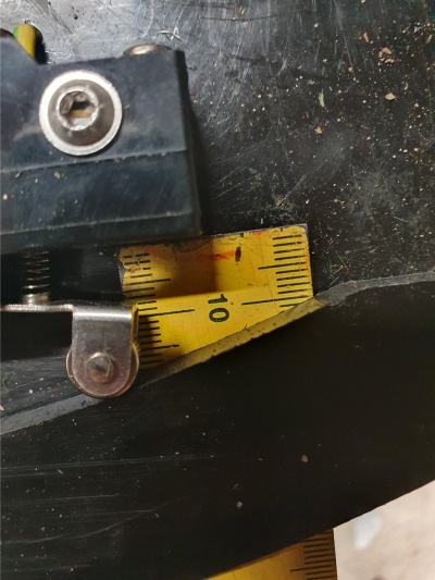

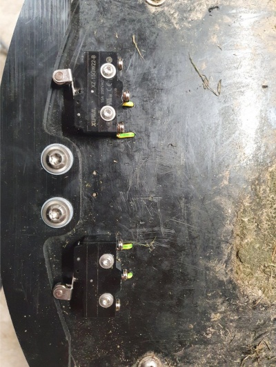

The Ardumower (switch-based) bumper is available in the Marotronics shop. You can find photos and the connection wiring below.
Photos
Ardumower bumper1.jpeg Ardumower bumper2.jpeg Ardumower bumper3.jpeg Ardumower bumper4.jpeg Ardumower bumper5.jpeg Ardumower bumper6.jpg
