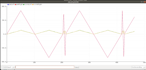

Additionally, there is a motor plot for odometry signal quality diagnostics.
  1. Make sure the robots tires can move freely in the air
  2. Start Arduino IDE, choose the UART port (Tools->Port from the menu)
  3. Choose Tools->Serial Monitor from the menu, and send 'AT+Q' (ENTER) to the robot (115200 baud). The motor plot will start and motor PWM and odometry signal quality will be plotted:
