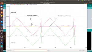

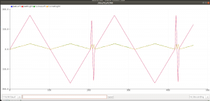

Additionally, there is a motor plot for odometry signal quality diagnostics (including mower motor).
  1. Make sure the robots tires and the mower motor can move freely in the air (see photo below)
  2. Start Arduino IDE, choose the UART port (Tools->Port from the menu)
  3. Choose Tools->Serial Monitor from the menu, and send 'AT+Q' (ENTER) to the robot (115200 baud). The motor plot will start and motor PWM and odometry signal quality will be plotted for a short moment:
Further odometry hardware trouble-shooting (how to measure odometry hardware faults): https://forum.ardumower.de/threads/antriebsmotoren-brushless-pl%C3%B6tzlich-im-schneckentempo.24822/post-54494

Note: You can test the ultrasonic sensors using the sensor test. Start Arduino serial monitor and send 'AT+F' (with ENTER) to the Arduino to start the sensor test.
