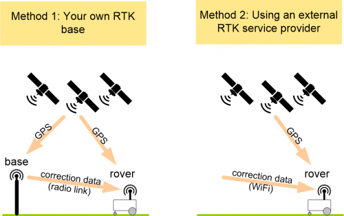

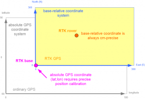

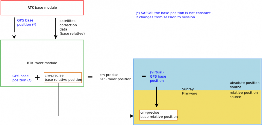

What is RTK and what are the requirements (environment and hardware)

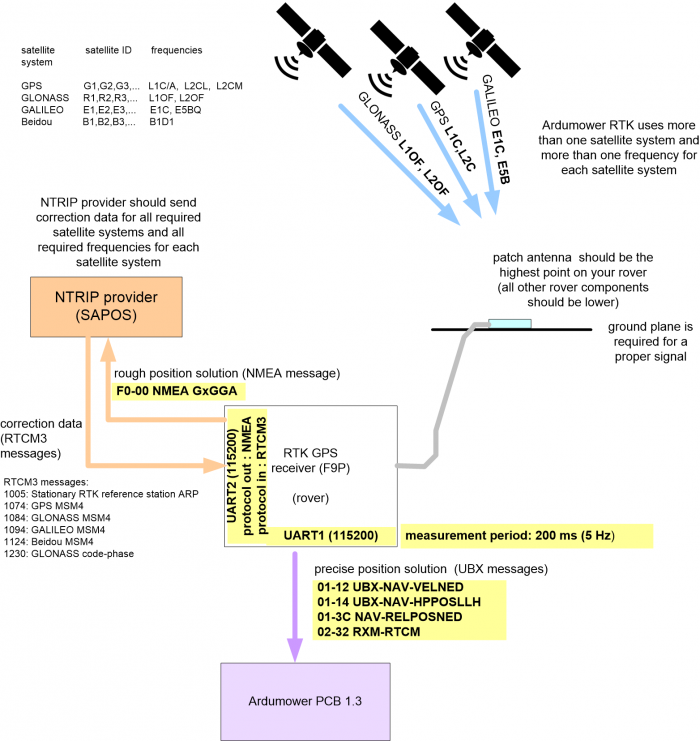

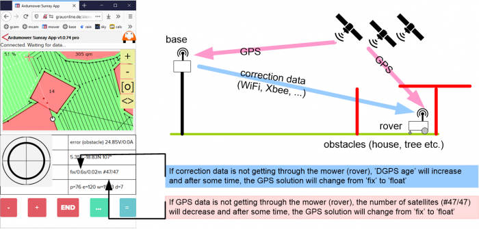

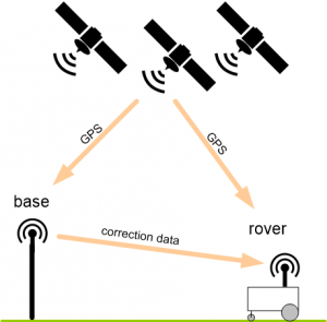

RTK-GPS uses two GPS receivers, one for the reference antenna (base) and one for the robot mower (rover) which both communicate in realtime via radio modules (see image below). The base constantly sends correction data so the rover can compute its cm-precise (relative) position. In the RTK-GPS kit, everything required (receivers, radios, antennas etc.) is included. Also, if you don't want to operate your own RTK base, you can use an external base service via Internet (e.g. like SAPOS in Germany, FLEPOS in the Netherlands, SWEPOS in Sweden, ASG-EUPOS in Poland, and others). This will reduce the hardware cost by about a half. If using your own RTK base, long-range radio modules (e.g. 868 Mhz) are preferred over standard 2.4 Ghz radio modules as they better penetrate buildings, trees etc. NOTE: Using your own RTK base is highly recommended as this will give most robust (RTK fix) position results!

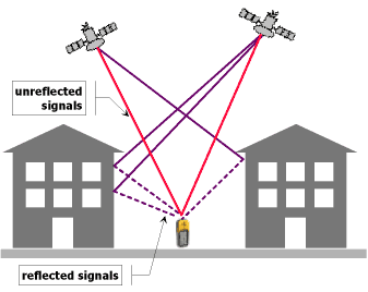

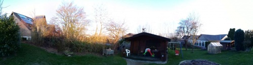

To be able to use RTK-GPS, your robot mower should have a good and open view to the sky at all locations (see photo below). RTK-GPS will NOT work under extreme limited sky view, near walls, in buildings, in narrow areas with larger obstacles all around. There should be at least 15x15m free space on the lawn (without walls and too many trees) to get a robust RTK fix solution on the complete lawn.
Some of the environments where we successfully tested RTK GPS:
Environment 'AG' (mostly unobstructed sky view)
Environment 'ML' (partial obstructed sky view due to large trees on the lawn)

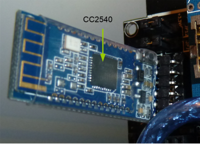

Bluetooth BLE UART module (HM-10)
1. Install Bluetooth 4.0/BLE module (range 10m, 8 Kbps) on your Ardumower PCB1.3/1.4 (replace any installed Bluetooth 2.0 module).
IMPORTANT: Verify the pinout of your BLE module is matching your Ardumower PCB pinout (shown at the PCB1.3 back side)!
2. Set JP10 (BlueS - Bluetooth signal level) to 3.3V
3. Set JP4 (BlueV - Bluetooth voltage) to 5V
4. Set JP6 (WIFI voltage) to 3.3V
5. Set JP11 (WIFI signal level) to 3.V

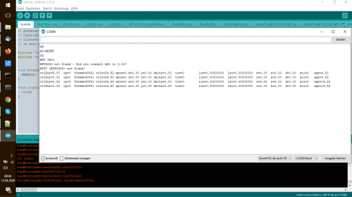

NOTE: If your experience Bluetooth module communication issues, have a look at the GPS RX pin fix and perform the same RX pin fix for the Bluetooth RX pin.
You can find a list of working combinations of BLE-module and smartphone on this page: BLE-Module_-_List_of_variants.
The BLE firmware version of your module is shown in the Arduino IDE serial console at robot boot time:
https://docs.google.com/document/d/14qa15AKLG0EUfNJKfFPwAsKfrLlM0yoqJ1TyiM5c9Fk/edit?usp=sharing
If you have BLE firmware 5.3, the module may not work correctly or stable and it is recommended to use an ESP32 as a BLE+WiFi module (see below)

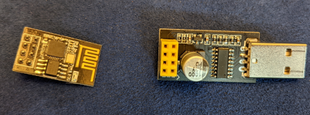

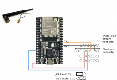

Bluetooth BLE/WiFi UART module (ESP32)
Due to the many issues with latest firmwares (on both BLE HM-10 modules and WiFi ESP8266), we decided to replace both BLE and WiFi modules by a single new module (ESP32). It works by removing any existing BLE and WiFi module and connecting the ESP32 to the PCB1.3/1.4 Bluetooth connector as shown below.
1. Install ESP32 BLE+WiFi on your Ardumower PCB1.3 (replace any installed Bluetooth 2.0 module).
4. Download the ESP32 BLE+WiFi firmware and using Arduino IDE, configure your WiFi user+password in the code, and finally install as shown in the screenshots at this link: https://github.com/Ardumower/Sunray/tree/master/esp32_ble

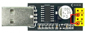

NOTE: If your ESP32 is not available as a device, you may have to install an USB driver: https://www.silabs.com/developers/usb-to-uart-bridge-vcp-drivers

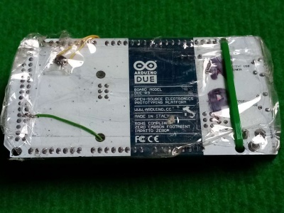

Step 1: Swapping pins (only PCB1.3)
The pins TX3 and RX3 are incorrectly routed on PCB1.3 - Fix it by swapping the TX3 and RX3 pin headers as shown below.
You can see the fixing process in this video: https://youtu.be/T-EqU5azCAU?t=140

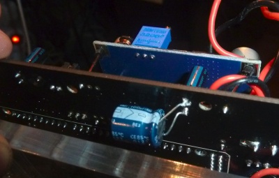

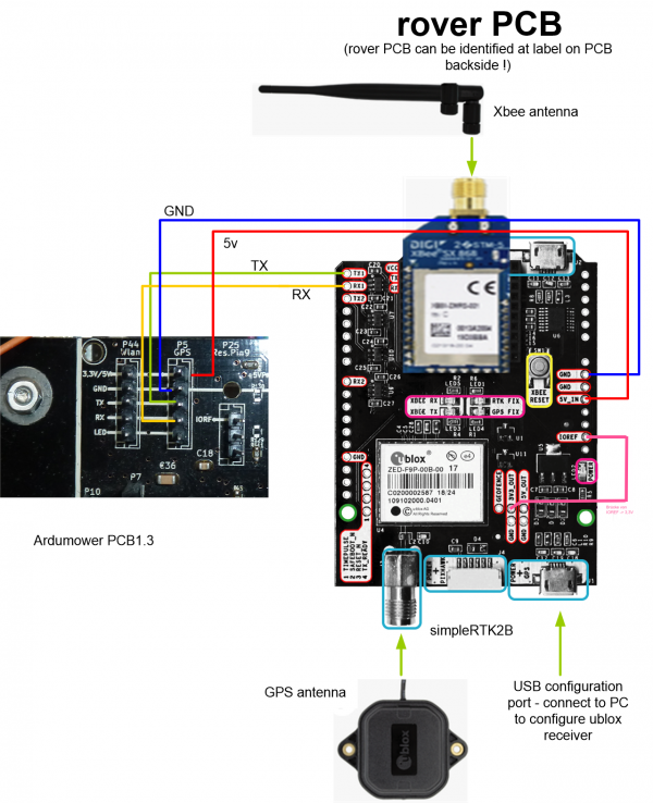

Step 2: Fixing GPS_RX pin ('GPS wire fix') (only PCB1.3)
P5 GPS_RX is not working as expected on PCB1.3. Fix it with these steps:
- Directly connect P5 GPS_RX and Arduino TX3 using a wire at the PCB backside as shown below.
- Remove jumper Gps_S (JP12)
- IMPORTANT: On the rover GPS module, connect simpleRTK2B IOREF to simpleRTK2B 3V3_OUT (to choose signal voltage level 3.3v).

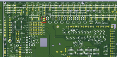

The PCB1.3 odometry divider for the left and right motors should be configured as follows (NOTE: no need to change the mower divider, you can keep your existing mower divider configuration):

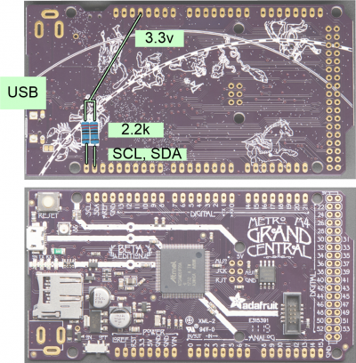

Adafruit Grand Central M4
Using the new Adafruit Grand Central M4 instead of Arduino Due is highly recommended as it has more working memory (RAM) for maps and a floating point unit for faster computations.
Installations steps:
1) Add 2.2K/activate resistors (aka 'I2C pull-up') to the Adafruit Grand Central M4 board as shown below, depending on you Board-Version (PCB 1.3 vs. PCB 1.4). NOTE: If the pullups are missing, the Ardumower Sunray firmware will hang at boot time and nothing will be displayed on serial console output!
| PCB 1.3 | PCB 1.4 |
| Add external resistors (2k2 Ohm) on Grand Central M4. |
Bridge the two marked jumpers on PCB 1.4. |
2) Disable Ardumower PCB1.x jumper JP13 (deactivate Arduino Due clone reset circuit).

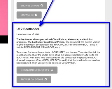

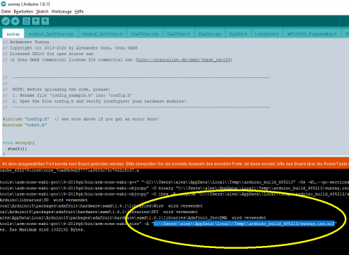

3) It is highly recommended to upgrade the bootloader on the Adafruit Grand Central M4 board. Download the the latest bootloader file here (look at the bottom of this link for .UF2 bootloader file): https://circuitpython.org/board/grandcentral_m4_express/
4) Connect the Adafruit Grand Central M4 via USB to your computer.
5) Press the RESET button on the Adafruit Grand Central M4 twice, the larger LED on the Adafruit Grand Central will become GREEN, and a new drive will appear in Windows Explorer/Mac Finder ('GCMBOOT').
6) Copy the .UF2 bootloader file to the Adafruit Grand Central M4 drive ('GCMBOOT') - the drive will disappear and after 10 seconds the drive will appear again. The bootloader upgrade has finished (Alternative instructions here: https://learn.adafruit.com/adafruit-grand-central/update-the-uf2-bootloader).

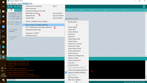

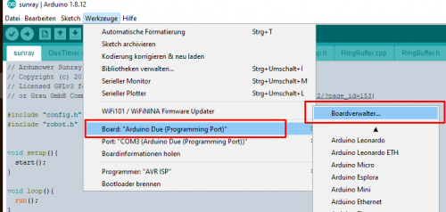

7) Follow the instructions here to add 'Adafruit Grand Central M4' support to the Arduino IDE by installing both Arduino SAMD boards and Adafruit SAMD boards packages : https://learn.adafruit.com/adafruit-grand-central/setup

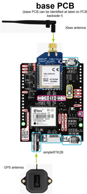

Method 1: Your own RTK base
This is the recommended installation method as it also will give you RTK fix solution results in cloudy weather conditions. Your own RTK base should be located max. 8 km away from your mowing area. The GPS antenna should have a clear sky view and is ideally mounted at a high (and steady) position. Using long-range (LR) wireless radio-frequency (RF) modules, the GPS correction signal is transmitted to the robot (it's a one way transmission). Multiple robots can be operated by a single RTK base. Using long-range radio modules (e.g. 868 Mhz) is preferred over standard 2.4 Ghz radio modules as they better penetrate buildings, trees etc.
WARNING: Handle your GPS modules with care, it is an expensive piece of hardware. If you have any doubt, or if you are unsure, please ask in the Ardumower forum for help.
1. Make sure you have the simpleRTK2B module marked as 'BASE' in your hands (look at simpleRTK2B PCB label at backside!)
2. Connect Xbee LongRange dipole antenna
3. Connect GPS multifrequency patch antenna. NOTE: antenna cable is very sensitive, never bend the antenna cable! Minimum bend radius: 5cm!
4. Connect a USB 5v power supply to the USB port marked as 'POWER+GPS'

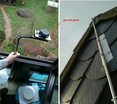

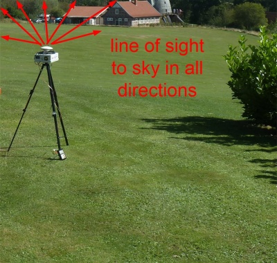

5. Install the GPS base antenna - it should have clear view to the sky in all directions without any obstacles. For best results install GPS antenna on the roof. Alternatively, if you have an open area (without trees and other obstacles), you can install the base antenna on a tripod.
NOTE: The robot mower will get and save all position coordinates relative to the base antenna (East, North) - do not move the base antenna after recording the virtual perimeter with the phone app.
6. Improving position solution robustness: for robust position solutions (FIX), you will need to install a (conductive) ground plane (10x10cm, make it round if possible) for the patch antenna. Install the patch antenna on top of it like shown below. This will give you most robust position results.

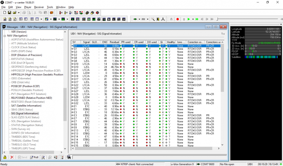

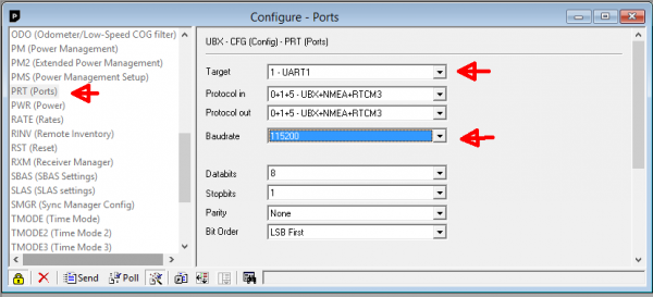

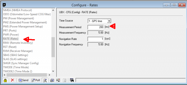

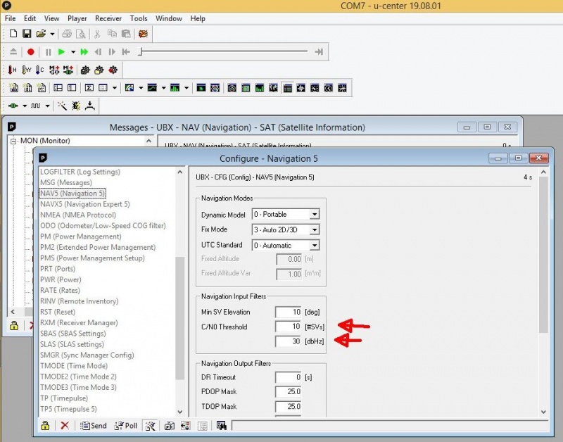

7. Download ublox u-Center v21.05, install it and start it: Download link
8. Choose 'Receiver->Connection' and choose your base module COM port. NOTE: If you cannot see a COM port, you may have to install ublox VCP driver (and/or choose the serial driver for the detected GNNS device in Windows device manager).

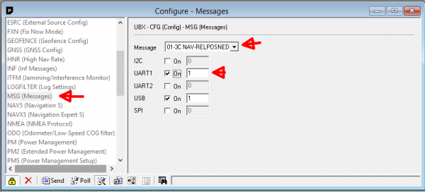

9. Choose 'View->Configuration View'. Choose configuration message 'TMOD3(Time mode 3)' and choose:
- Mode '1 - Survey-In' (90s/5m precision) if you use 'relative coordinates' in the App (recommended). It's ok to choose such a worse precision as this is related to absolute GPS world coordinates only and we don't use this (unprecise) absolute world coordinate when using (cm-precise) relative base coordinates.
- Mode '2 - Fixed Mode' if you used 'absolute coordinates' in the App (not recommended). Enter your base coordinates as shown in the image. NOTE: You can find out your precise bases coordinates using the 'Survey-In' mode which will take several hours to get down to a precise position. NOTE: You can run the survey-in and compare the GPS solution coordinates (latitude and longitude) from hour to hour. If they do not change anymore, your base coordinates are precise.
10. Click on 'Send'. Your base should get a '3D' position solution (verify this!).
10. From the u-Center menu, choose 'View->Configuration', choose configuration message 'CFG (Configuration)' and click on 'Send' to make the configuration in the base persistent when the rover module is powered off. Do not forget to save the configuration (Receiver -> Action -> Save Config).

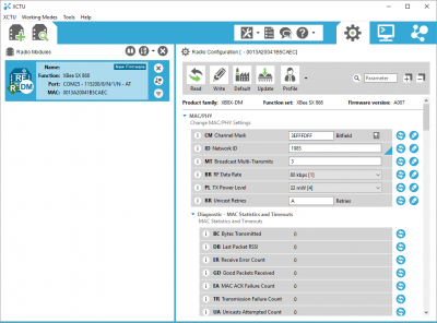

11. Tip if using multiple XBee LR kits (base and rover pairs) within a 10km area: The XBee LR kits are all configured with the same network ID. So if one rover is in the range of two base stations, there's going to be cross talk and the rovers will start doing funny things. For the XLR kits are configured with a unique ID per kit, to avoid the situation. Nevertheless the LR kits only really work with line of sight, if the base station antenna is not mounted in the top of the house and can see all the neighbourhood, is quite unlikely that the arrive more far than a couple of houses away.
You have 2 options to solve this problem:
- Configure each pair in unicast mode so each base station only talks to specified rover.
- Change the network ID for each pair (PAN ID).
These can be done with the tool Digi XCTU.

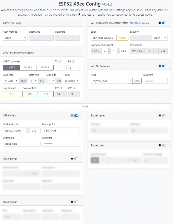

Method 2: Using an RTK external base service (Internet-based)
This section describes how to use an external Internet-based correction service (NTRIP, e.g. SAPOS in Germany, FLEPOS in the Netherlands, SWEPOS in Sweden, ASG-EUPOS in Poland, and others) instead of your own base station. You can reduce cost with this method because you don't need an RTK base PCB. Instead you will require the WiFi NTRIP Master module for your rover PCB from Marotronics. Follow these steps for the rover PCB:
1. Instead of the XBee module install the WiFi NTRIP Master module on your rover PCB as shown in above photo.

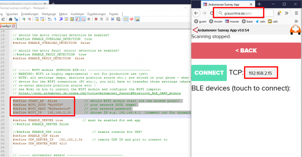

2. Use your smartphone or laptop to connect to the WiFi network that the module created, with name “ESP_XBee_XXXXXX” where XXXXXX is a random number.
3. Go to your browser and type the following address “192.168.4.1”, a web interface will appear.
4. Configure your preferred NTRIP service provider (host, port, mountpoint, username, password), and through which WiFi network should it connect to internet. Example NTRIP mount points (Germany SAPOS service generating virtual reference station):
Nordrhein Westfalen (SAPOS HEPS): VRS_3_4G_NW Niedersachsen (SAPOS HEPS): VRS_3_2G_NI Berlin (SAPOS HEPS): VRS_3_2G_BE Baden Württemberg (SAPOS HEPS): VRS_3_3G_BW
Additionally, you can find out more NTRIP casters here:
- http://www.epncb.oma.be/_networkdata/stationmaps.php
- https://igs.bkg.bund.de/dataandproducts/streams
5. Use UART0 and 115200 baud for the connection to the ublox GPS receiver (rover).
6. Save configuration and reset the system. From now on, every time the WiFi router you configured is in range, the WiFi NTRIP Master will connect autonomously and provide RTK corrections to your rover PCB (If you ever experience any problems and are unable to connect to the NTRIP master device, you can hold the NTRIP master BOOT button for 5 seconds and the ESP32 will be reset to its default configuration). Verify that your XBee-Wifi-module is successfully connected to the Internet by typing the configured XBee IP address in your browser!
7. Connect the rover PCB via USB to your PC, and make sure NMEA protocol out is activated for UART2 out at 115'200bps (configuration view-> message 'PRT (Ports)'). Also make sure NMEA GGA message is active with rate 60 on UART2 (configuration view->message 'MSG (Messages)'->F0-00 NMEA GxGGA). Some NTRIP service providers need this NMEA message to compute a virtual base station (VRS) based on the initial estimated GPS fix position. Verify that the LED GPS-XBEE starts to blink which means the GPS receiver is sending the (rough) GPS position to the XBee module!
8. Finally, verify the LED 'XBEE-GPS' is blinking (the rover receives correction data) and the correction age (seconds) shown near the fix solution in the phone app is not increasing. If it does NOT work:
- Verify you have properly configured the rover module (see further below)
- Verify your NTRIP client connection data via ucenter (see further below)
- Activate NTRIP module console output (log forward print), connect GPS rover module via the 2nd USB port (near the NTRIP module) to your PC and start Arduino IDE serial console to monitor the console output
9. If your NTRIP base antenna position is not constant, you have to switch to position source mode 'absolute' in the App (see section App for more details).
How can I find out if my NTRIP provider (e.g. SAPOS) properly works and supports the required correction messages
You can verify the received correction messages (RTCM3) for the individual satellite systems (GPS, GLONASS, etc.) via ublox uCenter. Start the NTRIP client via 'Receiver->NTRIP client...'
...and then display the received RTCM3 messages via 'View->Messages View->UBX->RXM->RTCM':
These are the RTCM3.3 messages you should see and may see ( * means not supported by F9P receivers , --> means this message should be activated when using your own F9P RTK base station):
1001: L1-only RTK observables
1002: Extended L1-only RTK observables
1003: Compact L1&L2 observables
1004: Extended L1&L2 observables
--> 1005: Stationary RTK reference station ARP
1006: Stationary RTK reference station ARP with height
1007: Antenna descriptor
*1008: Antenna descriptor and serial number
1009: L1-only GLONASS observables
1010: Extended L1-only GLONASS observables
1011: GLONASS basic RTK L1&L2
1012: GLONASS extended RTK L1&L2
*1013: System parameters
*1019: GPS ephemeris data
*1020: GLONASS ephemeris data
*1021: Helmert/Abridged Molodenski Transformation Parameters
*1023: Residuals, Ellipoidal Grid Representation
*1025: Projection Parameters, Projection Types other than Lambert Conic Conformal
*1032: Physical Reference Station Position
1033: Receiver and antenna descriptors
*1073: GPS MSM3
*1083: GLONASS MSM3
*1093: GALILEO MSM3
*1123: Beidou MSM3
--> 1074: GPS MSM4 --> 1084: GLONASS MSM4 --> 1094: GALILEO MSM4 --> 1124: Beidou MSM4
1075: GPS MSM5
1085: GLONASS MSM5
1095: GALILEO MSM5
1125: Beidou MSM5
1077: GPS MSM7
1087: GLONASS MSM7
1097: GALILEO MSM7
1127: Beidou MSM7
--> 1230: GLONASS code-phase (this message could be missing - then 1033 should be received instead!)
You can verify the satellite frequencies via 'View->Messages View->UBX->NAV->SIG':
These are the frequencies you should see for each satellite system:
GPS G1,G2,G3,... L1C/A
L2CL
L2CM
GLONASS R1,R2,R3,... L1OF
L2OF
GALILEO E1,E2,E3,... E1C
E5BQ
Beidou B1,B2,B3,... B1D1
And finally, you should see a carrier solution 'float' or 'fix' for a RTK solution:
RTK rover

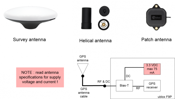

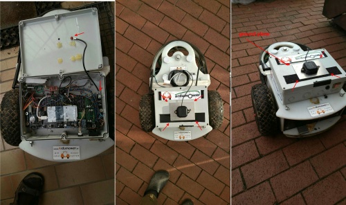

Make sure you have configured the Ardumower PCB (1.3/1.4) GPS jumpers as shown in the Ardumower PCB GPS section above correctly.
1. Make sure you have the simpleRTK2B module marked as 'ROVER' in your hands (look at simpleRTK2B PCB label at backside!)
2. Connect XBee LongRange dipole antenna
4. Connect PCB1.3_GPS_GND to simpleRTK2B GND
5. Connect PCB1.3_GPS_5V to simpleRTK2B 5V_IN
6. Connect PCB1.3_GPS_TX to simpleRTK2B TX1
7. Connect PCB1.3_GPS_RX to simpleRTK2B RX1
8. IMPORTANT: Connect simpleRTK2B IOREF to simpleRTK2B 3V3_OUT (to choose signal voltage level 3.3v) (please IGNORE the photo for IOREF connection!)
9. Install XBee antenna and GPS antenna on the Ardumower. The GPS antenna must be mounted at the point where the robot rotates around (aka the 'control point'). For a 2 differential wheel robot, this position is at the tire axle and between both tires. Do not mount the GPS antenna too high because when there's slope the higher position of the antenna is not the same as the position of the robot (see example with slope below):

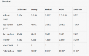

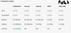

10. Improving position solution robustness: for robust position solutions (FIX), you will need to install a (conductive) ground plane (10x10cm, make it round if possible) for the patch antenna. Place the patch antenna on top of it like shown below. This will get you most robust position results. Note: you do not have to ground the ground plane as the contact to antenna is capacitive.
More details about ground planes for patch antennas can be found in the u-blox GNSS Antennas Application note (UBX-15030289) and in ublox Multi-band, high precision GNSS antennas (ANN-MB series).

5. In this step we want to turn off all broadcast messages except one. Choose 'View->Configuration View'. Choose configuration message 'MSG (Messages)' and select one message after the other in the list (0A-37 MON-HW3, 0A-09 MON-HW, ..., etc.). For each message, make sure the selected message is turned off for UART1 and UART2. Example for message '01-22 NAV-CLOCK' that has been deactivated for UART1:
Repeat this step for all messages in the listbox and turn off all messages for UART1 and UART2.
6. Activate the following messages and rates for UART1 and USB:
01-07 UBX-NAV-PVT 10 01-12 UBX-NAV-VELNED 1 01-14 UBX-NAV-HPPOSLLH 1 01-3C NAV-RELPOSNED 1 01-43 NAV-SIG 10 02-32 RXM-RTCM 5

8. Choose configuration message 'PRT (Ports)', choose 'UART1', and set baudrate to 115200 for UART1:
9. Choose configuration message 'RATE (Rates)' and set measurement period to 200ms (5 Hz):
10. From the u-Center menu, choose 'View->Configuration', choose configuration message 'CFG (Configuration)' and click on 'Send' to make the configuration in the rover persistent when the rover module is powered off.

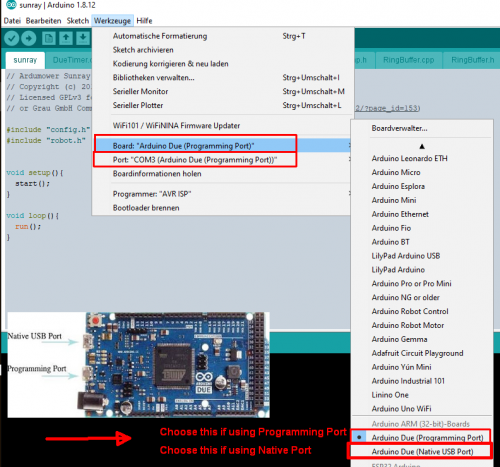

In this section you will upload the Arduino code ('Sunray Firmware') to your Ardumower. (Tip: You can watch below steps in this video (German): https://www.youtube.com/watch?v=vzREteqtzac)
1. Download and start Arduino IDE: https://www.arduino.cc/en/Main/Software
2. Download Ardumower Sunray Firmware release and unzip it: https://github.com/Ardumower/Sunray/releases
(NOTE: the Github 'master' branch may contain a newer but unstable version: https://github.com/Ardumower/Sunray/archive/refs/heads/master.zip)
3. Open the Arduino sketch 'sunray\sunray.ino'.

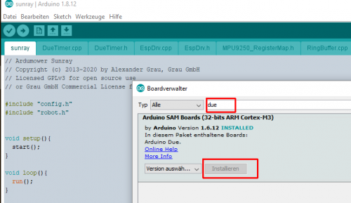

4.1 For Arduino Due: In Arduino IDE, choose 'Tools->Board->Manage' and enter 'Due'. Install the 'Arduino SAM Boards'
4.2 For Adafruit Grand Central M4: Follow the instructions here to add 'Adafruit Grand Central M4' support to the Arduino IDE by installing both Arduino SAMD boards and Adafruit SAMD boards packages : https://learn.adafruit.com/adafruit-grand-central/setup
NOTE: If you get compilation errors with Adafruit Grand Central M4, you may have to downgrade 'Adafruit SAMD Boards' to version to 1.7.5.
5. Start your Ardumower (via the PCB1.3 button P20).

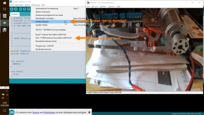

6. Connect Arduino Due USB native port (or Adafruit USB port) to your Computer's USB port. In the Arduino IDE, choose the correct board and port and Upload the sketch to your Arduino Due/Adafruit Grand Central on the Ardumower PCB1.3. After a short while you should hear a 'beep'. Ardumower is now ready for your commands!

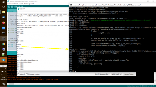

7. If you experience problems (e.g. phone cannot connect to your Bluetooth module), it is recommended to view the serial console of the Ardumower. Connect the Arduino Due via the USB port labeled 'native' to your PC. Choose board 'Arduino Due native USB port' in the Arduino IDE and choose the available Due native COM port. Then choose 'serial monitor' to see the console. Finally choose upload. After uploading, the output on the console should appear and should look like below. The lines 'OK', 'AT+RESET', 'OK' indicate that the Bluetooth module was found. Also, if your Bluetooth module is not listed in the App,ensure that you give the App Bluetooth permissions.
For more details about the console debugging, see:

| invalid | no DGPS solution was found |
| float | DGPS solution was found but it is ambiguous and therefore not precise (average error ~20cm). |
| fix | DGPS solution was found and it is cm-precise - position is tracked in realtime (RTK) |
| age | The age (in seconds) of the DGPS correction data sent from base |

Position source mode
RTK: DGPS can solve the precision problem between a fixed base and a moving rover. However, it cannot compute absolute GPS coordinates (latitude/longitude) precisely. To be able to compute absolute GPS coordinates for a moving rover, you have to know the absolute coordinates of the base. Then the rover can add the precise relative measurements to the absolute base coordinate to compute a precise GPS coordinate.
The ublox GPS receiver sends two positions to the Ardumower:
a) one base-relative position (east/north) in meters (this is used in relative mode)- because virtual base station (VRS) coordinates move each start, this mode cannot be used for SAPOS/VRS b) one absolute latitude/longitude position (this is used in absolute mode and the base coordinate set in the app is always substracted from this to calculate again east/north in meters)
To save memory, the rover will always use relative coordinates for the map etc. The map origin (0,0) for the maps can be choosen in the App. WARNING: The relative coordinates cannot be larger than +/-300m. You have to ensure that the map origin (0,0) is not further away than 300m from all recorded points in your map.
In the App (menu 'Position mode'), you can choose between those two position source modes:
relative: the rover coordinates are always relative to the base antenna (recommended - use this when using your own base) - if the base
moves after a map recording, you have to switch to absolute mode
absolute: the rover coordinates are computed as relative to some specified (e.g. your base antennna or house)
world coordinate (see image below - use this when using an NTRIP client or for a different base position)
Tip: You can use Google Maps to find out (Lon, Lat) coordinates for your location and use them as coordinate (lon,lat) for your base station to set up the absolute position mode: https://www.latlong.net/

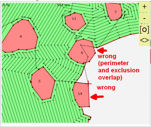

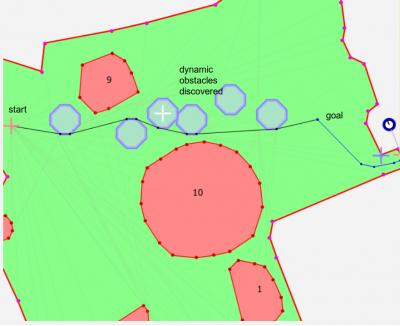

Record perimeter and exclusions
Please watch this help video on how to record perimeter and exclusions:

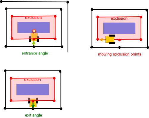

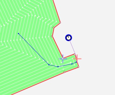

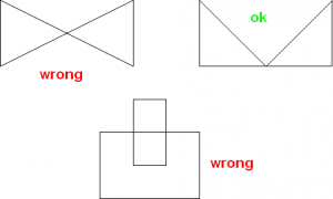

When recording perimeter and exclusions make sure that your perimeter polygon and each of your exclusion polygons do not overlap itself and other polygons.
Example of one polygon overlapping itself and one polygon overlapping another polygon (not allowed):
Also, when recording your exclusions, make sure there is enough space around obstacles for entry and exit points where the mower needs to rotate!
Important: Ensure that you record no 90 degree corners but instead approximate it with smaller changes in angles. This will make your robot turning actions smaller:

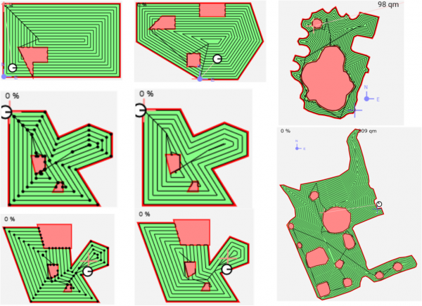

Mowing pattern, pattern angle, mowing offset
Click here for video demonstration of patterns, pattern angle and mowing offset

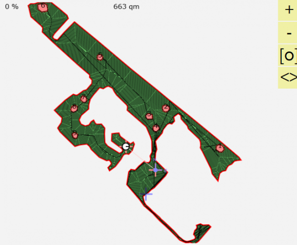

Example maps:
Tip: If you encounter path errors in the calculation, try to move the robot to another area (another position) and then recalculate the waypoints.

The base and rover LEDs can be used for trouble-shooting. Verify that the LEDs are acting as described below.
The base and rover LEDs should be as follows:
| GPS>XBEE | should blink - your base module is sending satellite reference data to your rover module (via the XBee module) |
| XBEE>GPS | should be OFF - your base module should not receive any XBee/reference signal |
| GPS FIX | should blink - your base module has found a valid GPS signal |
| NO RTK | should be ON - your base module is not performing RTK (real time kinematic) |
| GPS>XBEE | should be OFF - your rover module should not send any XBee signal |
| XBEE>GPS | should blink - your rover module is receiving satellite reference data from your base module (via the XBee module) |
| GPS FIX | should blink - your rover module has found a valid GPS signal |
| NO RTK | should be OFF - your rover module has found a RTK FLOAT or FIX (is performing real-time kinematic) |

Depending on the robot's location (e.g. near trees), it may take some time to get a RTK FIX solution. Also, it appears this RTK FIX can get lost quickly in the first minutes (e.g. near trees). However, after several minutes running time, the RTK FIX is more robust (even near trees). So, for best position results, let the GPS 'warm-up' some minutes at a location with good sky view.
Fix correctness
NOTE: If you power-on the receiver (mower) at limited sky view, the receiver may get a RTK FIX solution but this FIX may be incorrect (and all following data is offset by this incorrect start position!). Therefore it is recommended to always power-on the receiver (mower) at a position with good sky view and to always power-on at the same position!
RTK float-to-fix recovery and false-fix issues

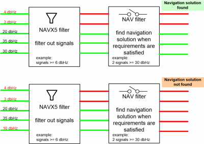

The described GPS filter below is now configured automatically in the Sunray firmware. Please skip this section.
If you experience RTK float-to-fix recovery issues (no fix after timeout), or if you experience (slightly) false-fix solutions, the problem might be satellite reflections in the navigation solution:
The solution to this problem is to configure a carrier to noise ratio filter (dBHz) like below (to filter out satellite reflections for a navigation solution). It is assumed that reflective signals have a significant lower signal strength than direct satellite signals.
Default navigation input filters settings:

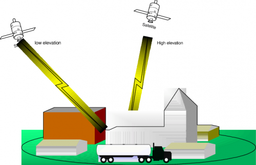

Min SV Elevation: 10 [deg]
C/N0 Threshold : 0 [#SVs]
0 [dbHz]
More restrictive navigation input filters settings (this will filter/reduce satellites required for a GPS navigation solution!):
C/N0 Threshold : 10 [#SVs]
30 [dbHz]
Min SV Elevation: Minimum elevation of a satellite (SV) above the horizon to start a navigation solution. Low elevation satellites may provide degraded accuracy, due to the long signal path through the atmosphere.
C/N0 Threshold: A navigation solution will only be attempted if there are at least the given number of satellites (SVs) with signals at least as strong as the given threshold.
These parameters were discovered experimentally using a GPS trajectory test with limited sky view and reflections:
Tip: You can use u-center to monitor the signal strength (CN0/dbHz) etc. of all satellites discovered by the GPS receiver:
If you want to look for the signal strength (CN0/dbHz) of the sent frequencies (L1,L2 etc.), you can do this as well:

...then you might have to increase the Arduino serial buffer FIFO size:
- In Arduino IDE->File->Preferences Click on 'preferences.txt' at the bottom
- For Arduino Due: locate file packages/arduino/hardware/sam/xxxxx/cores/arduino/RingBuffer.h
- For Adafruit Grand Central: locate file packages/adafruit/hardware/samd/xxxxx/cores/arduino/RingBuffer.h
- Change: #define SERIAL_BUFFER_SIZE 128 into into: #define SERIAL_BUFFER_SIZE 1024
- Recompile and re-upload the Arduino sketch

XBee RF bandwidth/corruption issues
The described GPS message rates below are now configured automatically in the Sunray firmware. Please skip this section.
We experienced that the XBee mid-range radio modules (2.4 Ghz) have a very limited bandwidth, activating the RTCM3 messages at highest rate (1 Hz) at the base may not work stable and data corruption can occur at the rover and the rover is not getting a stable RTK FIX. You can verify this by looking at the rover's MON-COMMS message using u-center or by looking at the App's 'DGPS(Xbee) checksum errors':
If the skipped bytes is increasing at a high rate (compared to the received bytes), your base (or rover or both) XBee is sending too much data and you can reduce the bandwidth at the base by reducing the message rates.
For the XBee mid-range modules the following rates have shown to reduce bandwidth and we were able to get a robust RTK FIX all the time:
---- base RTCM3 message rates --------------- rate 10 1005: Stationary RTK reference station ARP 1 1074: GPS MSM4 2 1084: GLONASS MSM4 3 1094: GALILEO MSM4 0 1124: Beidou MSM4 2 1230: GLONASS code-phase
You can change the message rates at the base via the configuration of the CFG-MSG message, choosing the above RTCM3 messages and setting zero (0) to turn a a RTCM3 message off or a non-zero rate value for the message rate. For example setting the rate to 1 means every GPS solution, 2 means every two GPS solutions etc. Do not forget to send and save the base configuration.
Addendum: another possible reason for limited bandwidth might be that the rover module is sending too much (unnecessary) data to the base, so stealing RF bandwidth. You can verify this using ucenter. Make sure that the rover is only sending the NMEA message GGA via UART2 (if you use NTRIP) with rate 60 or disable any outgoing messages for UART2 (if use your own base). You can change the messages sent via the configuration of the CFG-MSG message (see screenshot above).
Long-range and 10% duty cycle
The XBee long-range (LR) modules for Europe comply with the EU 10% duty cycle regulation (ETSI EN 300 220-2 V3.1.1) meaning that they radios do not send more than 10% of the possible data rate each second (among all channels). So, if e.g. we would encounter too much CRC errors at the GPS receiver XBee port it would proably mean the XBee sender was trying to send more than the 10% cycle (in a second), however the XBee module limited the traffic and stopped sending after the 10% resulting in a CRC error at the GPS receiver. So the best is to look if there are any CRC errors at the receiver to ensure the amount of data fits into the 10% cycle.
GPS antenna selection guide
We are currently experimenting with different GPS antennas for the rover. Generally, all antennas can be used in all environments. In very difficult environments, best fix-solution results have been reported by using the Survey antenna.
gain of different multi-band antennas:
Survey GNSS Multiband antenna: 40 dB Helical antenna for multiband GNSS: 33 dB Patch antenna for multiband GNSS: 28 dB

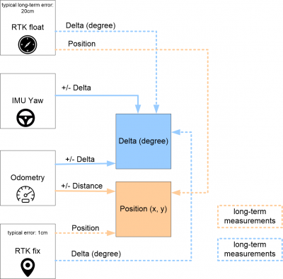

The following image shows how the sensor fusion of all data (RTK GPS, odometry, IMU) happens:

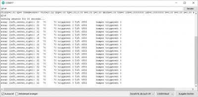

Note: You can test the ultrasonic sensors using the sensor test. Start Arduino serial monitor and send 'AT+F' (with ENTER) to the Arduino to start the sensor test.

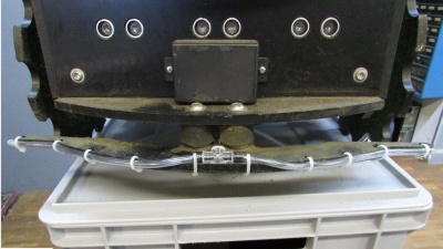

Bumper sensor
Optional (highly recommended): You can install a bumper bumper switch to add obstacle detection (in addition to the GPS feedback-based obstacle detection).
You can find more details about the bumper kit here: https://wiki.ardumower.de/index.php?title=Ardumower_Bumper
Note: You can test the bumper sensor using the sensor test. Start Arduino serial monitor and send 'AT+F' (with ENTER) to the Arduino to start the sensor test.
Obstacle detection and avoidance: For each detected (dynamic) obstacle, the robot firmware will set a temporary (dynamic) obstacle in front of the robot (shown in blue) and compute a new route from the current start position to the current goal position around all static and dynamic obstacles. Once the robot has reached the current goal position, all temporary obstacles are removed.

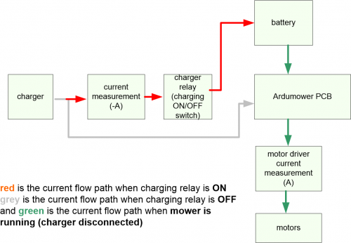

What electrical current does the App measure and show when in charging (App shows '-A') and mowing mode (App shows 'A')?
This is how the charging operation should look like in the Arduino IDE serial monitor / SD card log file:
volt=24 enableCharging=1 (charging relay is turned ON) volt=24, chg=0.2 (charging current is flowing into the battery) ...some time later... volt=25, chg=0.2 (charging current is flowing into the battery) ...many time later... volt=28, chg=0.0 (no significant charging current is flowing into the battery) enableCharging=0 (charging relay is turned OFF)
A note about the state 'charge' (indicated in the App): The robot will enter the state 'charge' once it measured a voltage at its charging pins. After the battery has been charged, the PCB charging relay is turned off (the battery is no longer charged), however the shown state will still be 'charge' (indicating the robot is still connected to the charger).

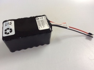

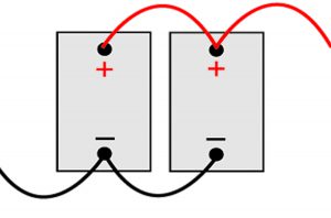

Tip: for longer battery operation time, connect two Ardumower batteries in parallel:
Or much easier: There are now two variants of the Ardumower battery pack, 125 Wh(5Ah) and 250 Wh(10Ah): https://www.asn-shop.de/Ardumower-Rasen-Roboter-Akku

Optionally, you can add a ESP8266-01 WiFi module (using ESP8266 NONOS SDK V2.2.1 firmware) found in the shop to your PCB1.3 and use it with the Sunray firmware. The computer browser (client) will communicate directly with the mower (server). So, the mower acts as HTTP server (TCP port 80) and the App as HTTP client (via web browser).
computer browser (HTTP client) ==> Mower (HTTP server, TCP port 80)
Demo video: https://www.youtube.com/watch?v=onsTfae-8VQ
Related topics: Sunray App connection issue solved (forum link)
NOTE: all settings (maps, absolute position source etc.) are stored in your phone - when using another device for the WIFI connection (computer etc.), you will have to transfer those settings (share maps via app, re-enter absolute position source etc)!
NOTE: Never connect with two devices (e.g. computer and phone) at the same time! (Close the App on the phone before using WiFi on the computer)
WiFi module (ESP8266)
- Ensure your ESP module is using firmware 2.2.1 (https://www.espressif.com/en/support/download/sdks-demos) like the Marotronics module
- Make sure you have set the WiFi jumpers (shown here).
- If you experience connection issues, you may have to add an additional capacitor (e.g. 470 uF/10V) to the module as shown in the photo. Also, do not use additional cables in between PCB1.3 and WiFi module if you experience connection issues.
- Look into firmware file config.h on how to configure SSID and (a static) IP.
- Look into the serial console (Download section, step 7) if you experience connection issues and to debug the connection process.
- If your home router does not allow servers within your home network, on your router, you may have to allow the mower IP address to receive packets via TCP port 80, so the App (client) can send packets directly to your mower (server)
- If you experience map upload errors in the App, check section above (GPS checksum error) on how to increase Arduino serial FIFO size.
Flashing WiFi module (ESP8266)
- If you need to change the ESP8266 firmware use the following tool: https://www.espressif.com/en/support/download/other-tools (Flash Download Tools).
- Ensure to download 'ESP8266 NONOS SDK V2.2.1 firmware' (https://www.espressif.com/en/support/download/sdks-demos)
- Before starting the flashing procedure, GPIO_0 must be connected to Ground for the entire flashing procedure to enable programming mode. The pins can be found here : https://components101.com/wireless/esp8266-pinout-configuration-features-datasheet. The configuration of the download tool looks like this (ignore the firmware version used in the screenshots):

Bluetooth Low Energy (BLE) and WiFi external antenna
You might use an ESP8266 (ESP-07) module like this and an external antenna from Marotronics (not tested by the Sunray author):
- ESP8266 (ESP-07): https://www.marotronics.de/ESP8266-WIFI-Wlan-Serial-Module-ESP-07
- antenna: https://www.marotronics.de/24-Ghz-Wireless-Antenne-mit-sma-Anschlusskabel-zB-fuer-ESP8266
Alternatively, this might be the right hack for you (tested by the Sunray author) :-) This is how I added an external SMA antenna (SMA female socket, SMA-male-to-female extension, SMA male antenna) to the Bluetooth 4.0/BLE UART module (CC2540) to increase range to approx. 20m. Happy hacking :-)
And this is how I added an external SMA antenna (SMA female socket, SMA-male-to-female extension, SMA male antenna) to the ESP8266-01 WiFi module
WARNING! Modifications to RF antennas, RF signal pathes on PCB's etc. are risky and you will loose general permission to operate the device - you may radiate additional unknown signals due to your modifications. Be warned of that! Tip: If you want to measure the performance of your antenna, you can use a 'RF antenna vector impedance/standing wave ratio measurement tool' (e.g. PS100/N1201SA).
What are the differences between the Ardumower and ArduSimple ublox receiver configurations
ArduSimple base/rover PCB port connections:
UART1: connected to Ardumower PCB1.3 (rover only) UART2: connected to XBee module USB: connected to computer (u-center)
Ardumower base (ublox F9P) configuration (identical with ArduSimple base config):
PRT (ports) protocol UART2 (XBee) in: RTCM3
protocol UART2 (XBee) out: RTCM3
baudrate UART2 (XBee): 115200 baud
RATE (rates) measurement period: 1000ms (1 Hz)
TMOD3 (Time mode3) mode: Fixed mode
Fixed Position: Your base lat/lon coordinates
MSG (messages) for UART2 (XBee) transmit frequency (10 means message is sent every 10 solutions):
F5-05 RTCM3.3 1005 Stationary ARP 1
F5-4A RTCM3.3 1074 GPS MSM4 1
F5-54 RTCM3.3 1084 GLONASS MSM4 1
F5-5E RTCM3.3 1094 GALILEO MSM4 1
F5-7C RTCM3.3 1124 Beidou MSM4 1
F5-E6 RTCM3.3 1230 GLONASS code-phase 1
Ardumower rover (ublox F9P) configuration:
additional activated messages (or changed message frequency) for UART1+USB:
MSG (messages) for UART1(Ardumower)+USB transmit frequency (60 means message is sent every 60 solutions)
F0-00 NMEA-GxGGA 60
01-3C UBX-NAV-RELPOSNED 1
01-43 UBX-NAV-SIG 10
02-32 RXM-RTCM 5
additional activated messages for UART2(XBee)+USB:
MSG (messages) F0-00 F0-00 NMEA GxGGA 60
RATE (rates) measurement period: 200ms (5 Hz)
PRT (ports) baudrate UART1 (Ardumower): 115200
protocol in UART1 (PCB1.3): UBX+NMEA
protocol out UART1 (PCB1.3): UBX+NMEA
protocol out UART2 (XBee): NMEA
protocol in UART2 (XBee): RTCM3
NAV5 (navigation 5) input filter:
Min SV elevation 10 default: 10
C/N0 Threshold #SVs 10 0
dbHz 30 0

- Adafruit M4: The firmware does not boot and there is no output in the console. Ensure that you have both pull-up resistors connected and that they have proper contact. If you have shrinkable tubing around the wires, check that there is no breakage within. Ensure that battery voltage is not too low (or remove battery - the PCB also works without battery).

- Does the 'DGPS age' shown in the App increase too much (>5 seconds)? If yes, verify your WiFi or XBee connection (see section extending outdoor WiFi above on how to improve WiFi connection). Also, verify the LEDs on the GPS modules - at the base, the LED 'GPS->XBEE' should blink and on the rover, the LED 'XBEE->GPS' should blink. Also, verify that your base is configured for 'Fixed Mode' and is getting a '3D' position solution (see section 'RTK base / Your own RTK base' above).
- Does the 'DGPS checksum error' shown in the App (Statistics) increase? If yes, verify your WiFi or XBee connection (see section XBee corruption issues above).
- Is the 'number of DGPS signals used' show in the App (example: #37/40 means 37 signals where DGPS was used versus 40 total signals) almost zero, or even zero (0/0)? If so, your base is not sending sufficient correction signals or the rover could not use the DGPS signals.
- Do you sporadically get 'GPS invalid' solutions? If yes, verify your WiFi or XBee connection (see above sections extending outdoor WiFi and XBee corruption issues). Also, verify your PCB1.3 DC/DC module voltage output.

How to record GPS data
For debugging purpose, all data sent by the ublox receiver (and received by the Ardumower PCB) can be recorded into a file via u-center. This log file can then be used to play back again the recorded data. So, it simulates the GPS receiver used during the recording.
Before recording, ensure all messages are enabled for USB too:
1. Connect your laptop computer (Windows) to the simpleRTK2B rover module USB port marked as 'POWER+GPS'.
2. Download ublox u-Center v21.05, install it and start it: Download link
3. Choose 'Receiver->Connection' and choose your rover module COM port.
4. Choose menu 'View'
5. Choose 'Configuration View'
6. Click on 'MSG (Messages)' at the message list most left
7. Choose message '02-32 RXM-RTCM'
8. Add 'USB On' there (add checkmark for USB)
Do the same for messages: 01-07 UBX-NAV-PVT 01-12 UBX-NAV-VELNED 01-14 UBX-NAV-HPPOSLLH 01-3C NAV-RELPOSNED 01-43 NAV-SIG 02-32 RXM-RTCM 0A-36 MON-COMMS
9. Save configuration:
10. Click on 'CFG (configuration)' at the message list most left
11. Ensure 'Save current configuration' is selected
12. Click on 'Send' button at the bottom
Steps to record your GPS receiver data:
1. Click on red 'record button' and choose a file name for the recording.
2. If being asked to save the receiver configuration, choose 'No' to skip that.
3. Now everything is not only sent from the GPS receiver to the Ardumower PCB but also saved in the record file. After finished the session, press stop button to stop recording.

For the very rare case that the Arduino hangs/stucks at a certain library, the watchdog in the Arduino has been programmed by the Sunray firmware to reset the Arduino.
However, if this reset happens too often, and you have the feeling it is a software issue, SD card logging might help to find out the code location for the hang/stuck.
IMPORTANT: For a full inspection, we will need both, your log files AND your compiled binary (sunray.ino.elf) !
1. Insert a FAT32 formatted microSD card into the Adafruit Grand Central M4
2. Activate SD card logging in your config.h
3. Locate the compiled 'sunray.ino.elf' file and make a copy of it (because Arduino IDE will delete the binary when closed):
3.1. In Arduino IDE, enable 'full output during compilation and upload' via menu File->Preferences
3.2 Compile the sunray.ino file
3.3 Look into the Arduino IDE output to find out the location of the compiled 'sunray.ino.elf' file
3.4 Using Windows Explorer, go into the shown folder and make a copy/backup of the 'sunray.ino.elf' file.
4. Run your robot. If some unexpected RESET appears, the Arduino will automatically save additional 'stack dump' information in the log file that corresponds to your compiled binary (sunray.ino.elf). Therefore the stack dump information only makes sense for your compiled binary.
For further inspection, send us both your SD card log files AND corresponding binary (sunray.ino.elf).
Developers/users can inspect the stack dump (found in the log files at the top) as follows. The stack dump contains RAM addresses that the CPU uses when calling a sub-function to remember the code address where to get back after completing that sub-function. By inspecting the stack addresses one can list all code locations (until the point where the CPU is running).
1. Locate the ARM GDB debugger in your Arduino Adafruit package and run it on the binary file (sunray.ino.elf):
> C:\Users\alex\AppData\Local\Arduino15\packages\adafruit\tools\arm-none-eabi-gcc\9-2019q4\bin>arm-none-eabi-gdb
c:\users\alex\AppData\local\temp\arduino_build_408598\sunray.ino.elf
2. To list the code for an arbitrary address found in the stack dump, use the GDB list command - Example: the stack dump contains address '0x8732' and you want to find out if that is a valid code address and what code is at that address:
(gdb) list *0x8732

In addition to the App, you can steer the robot via an R/C model controller. The R/C pinout (P13) is:
P13_1 +5V ----- R/C model controller VCC P13_2 GND ----- R/C model controller GND P13_3 pinRemoteMow ----- R/C model controller speed and direction channel (forward/backwards) P13_4 pinRemoteSteer ----- R/C model controller steering channel (left/right) P13_5 pinRemoteSpeed not used P13_6 pinRemoteSwitch not used
To activate R/C mode, power on robot and press START button (P20) for 3 seconds. Press again START button (P20) for 3 seconds to turn off R/C mode.

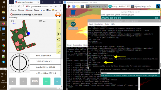

Hardware debugging
However, if this reset happens too often, and you have the feeling it is a software issue, hardware-debugging might help to find out the code location for the hang/stuck.
In the Github folder 'openocd' ( https://github.com/Ardumower/Sunray/tree/master/openocd ) you will find a 'readme.txt' that describes how to connect a Raspberry PI to the Arduino for hardware-debugging. The idea is to set a 'breakpoint' at the watchdog interrupt for the case that the Arduino resets. The hardware-debugger (Raspberry PI in this case) can then be used to get a backtrace of the last function calls to locate the problem in the code.
XBee module configuration
The XBee modules (LR/XLR) on ArduSimple PCB's are already configured. If you need to reconfigure for some reason, here's how to do so:
- Connect ArduSimple PCB USB (XBee side) to your PC
- Download XCTU software: https://www.digi.com/xctu
- Start XCTU
- Windows: If your the COM port for the XBee is not found, start Windows device manager, right-click on XBee USB device, choose 'update driver->find on this computer->choose from list on my computer' and finally choose 'Digit International->Digi USB Serial Port'
- In XCTU, choose 'Add radio module' and choose the COM port
- Settings found on the XBee SX 868 (Firmware version A007) - The sections marked in red are important:
Channel Mask: 3EFFFDFF Network ID: 1985 Broadcast Multi-Transmits: 3 RD Data Rate: 80 kps TX Power Level: 32 mW Unicast Retries: A - Routing/Messaging Mode: Standard Router[0] Broadcast Hops: 0 Network Hops: 7 Mesh Unicast Retries: 1 - Destination Address High: 0 Destination Address Low: FFFF Transmit Options: 40 Node Identifier: Network Discovery Back-off: 82 Network Discovery Options: 0 Cluster ID: 11 - Encryption: Disabled [0] AES Encryption Key: - Baud Rate: 115200 Parity: No Parity [0] Stop Bits: One stop bit [0] Packetization Timeout: 3 Flow Control Threshold: 11D API Enable: Transparent Mode [0] API Options: API Rx Indicator - 0x90 [0] - DIO0: Commissioning Button DIO1: Disabled DIO2: Disabled DIO3: Disabled DIO4: Disabled DIO5: Assoc. Indicator DIO6: Disabled DIO7: CTS flow control DIO8: Sleep Request DIO9: ON/SLEEP Output DI10: RSSI PWM0 Output DI11: Disabled DI12: Disabled DOUT: UART_DOUT DIN: UART_DIN DI15: SPI_MISO DI16: SPI_MOSI DI17: SPI_SSEL DI18: SPI_SCLK DI19: SPI_ATTN Pull Direction: FFFFF Pull-Up: FFFFF PWM0: 0 PWM1: 0 Associate LED Blink Time: 0 RSSI PWM Timer: 28 - Sleep Mode: Normal Sleep Options: 2 Number of Cycles Between Sleep: 1 Sleep Time: 190 Wake Time: 1F40 Wake Host Delay: 0
